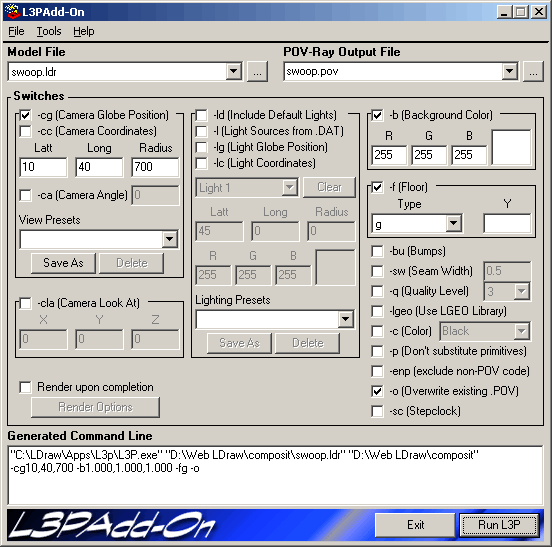

Convert the swoop.ldr file into a POV-Ray file by using L3P with the L3PAO graphical user interface. It does not matter what setting you use for L3P as long place the camera at a latt of 10 and ensure you have a floor. A latt of 10 is used becuse that is a good camera height in real life. Figure 2 shows the settings we used to make the swoop.pov file.
Figure 2: Converting a LDraw file to a POV-Ray file

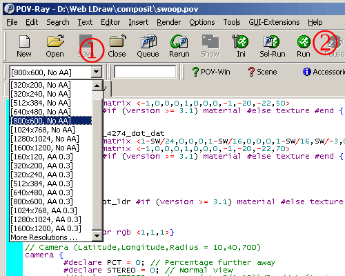

Render the file with a resolution of 800x600, use the drop-down menu (label 1 on figure 3) to choose your image size. Click on the run icon (label 2 on figure3) on the menu bar to begin the render process.

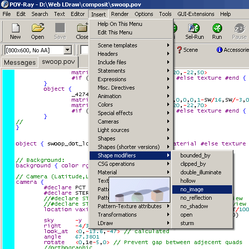

On the POV-Ray menu bar locate the "insert" menu and select the "shape modifiers" sub-menu and then click on "no image". See figure 5 if you need help.
Figure 5: The POV-Ray "no image" command
Note that the "no_image" command is now part of the object code.

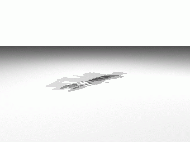

Now before we render the image WITHOUT the swoop bike we need to put back the floor so we get the swoop's shadows. So remove the "//" that you placed on the floor code in step 3. When you render the code you will notice that you get an image with 3 shadows as shown in figure 6.
Figure 6: Swoop Bike with 3 shadows
We only need one shadow as it will be easier to extract one shadow later on in our image editor. In oder to remove these shadows we need to make some of the POV-Ray lights "shadowless". That is lights that provide "light" but do not cast shadows!

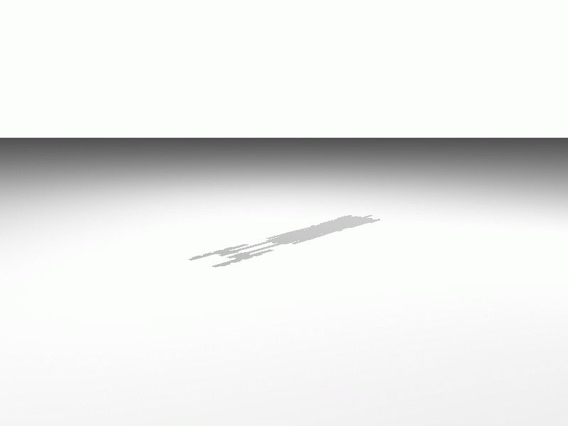

Locate your newly created image file (swoop.bmp) and rename it to swoop_shadow.bmp. The image should look like figure 7.
Figure 7: swoop_shadow.bmp

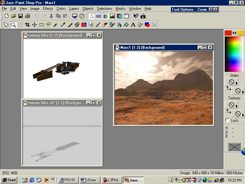

Open up swoop_nofloor.bmp, swoop_shadow.bmp, and desert.jpg. Your images should look similar to figure 8.
Figure 8: Working images in Paint Shop Pro

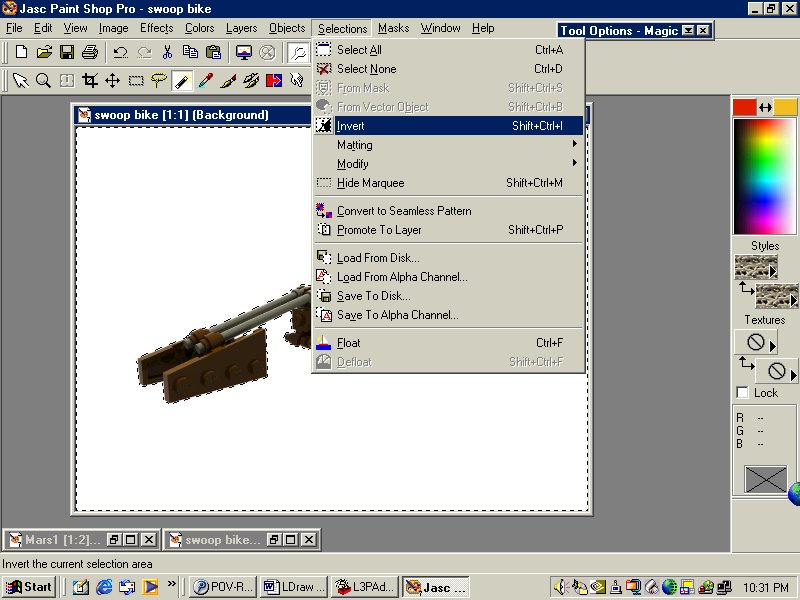

From the swoop_nofloor.bmp file we want to select just the model to place into the desert.jpg image.
Select the magic wand tool and set the tolerance to about 45, then click in the blank area (white area) of the model image.
Click on “selections” and then on “invert”, (see figure 9) you should now have only the model select.
Fihure 9: Swoop model selected

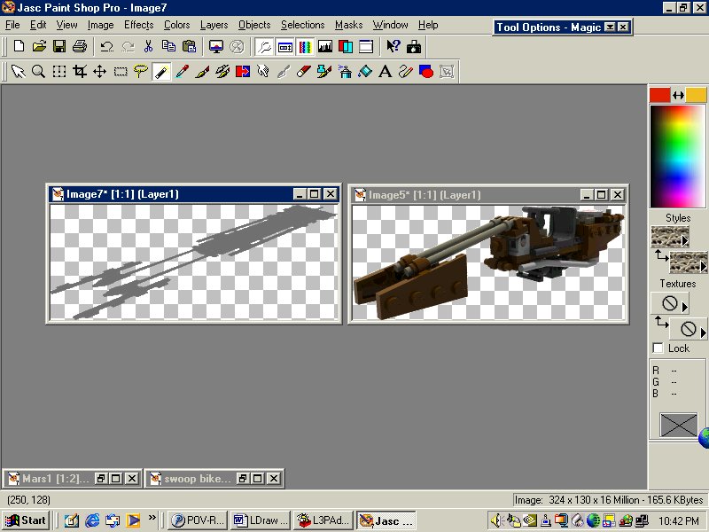

Click "copy" and opne a new file and click on "paste" to complete this step.
Repeat this step for the swoop_shadow.bmp file and just extract the shaodw. You should now have two new images as shown in figure 10.
Figure 10: New images of swoop and swoop's shadow

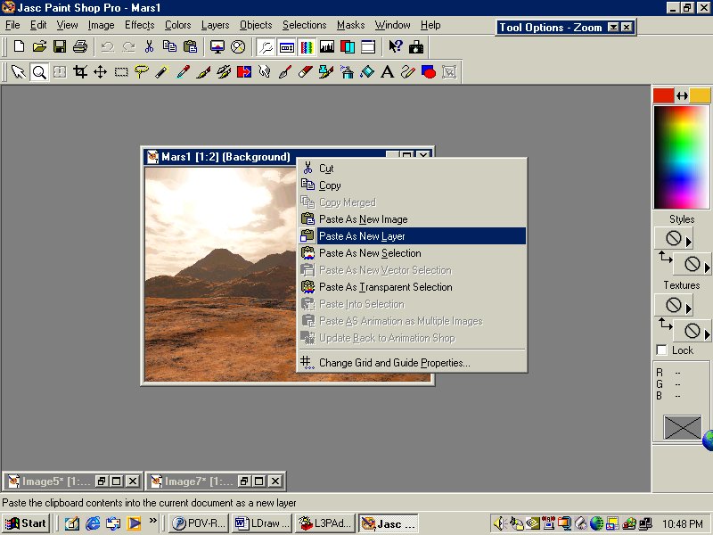

Now its time to import your two new images into the desert image.

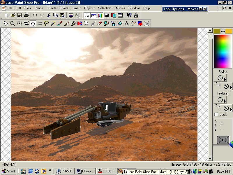

First select the new swoop shadow and click "copy". Open up the desert image and click "past as new layer" (see figure 11).
Figure 11: Pasting as new layers the swoop and it's shadow.

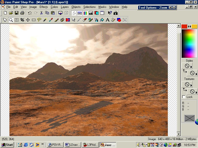

Adjuste the layer opacity of the shadow to 75% and place like shown in figure 12.
Figure 12: The swoop shadow in the desert image
Step PSP 4
Now "copy" and "paste as new layer" the swoop model and align it with it's shadow adn shown in figure 13.
Figure 13: Swoop and shadow in the desert.
Now you can see that it fits in pretty nicely but it still needs something. So what you have to do is go into the color menu and play around with the colors such as channel mixer, gamma correction, etc. until you get it to look like it’s actually there. You can also do other things such as add a little dust, or soften the shadows edge, and make the edges of the swoop bike blend more. Play around with it so you can get it how you want. The image in figure 1 has a much softer shadow than figure 13. This was done by using the soften technique under the tools option.
