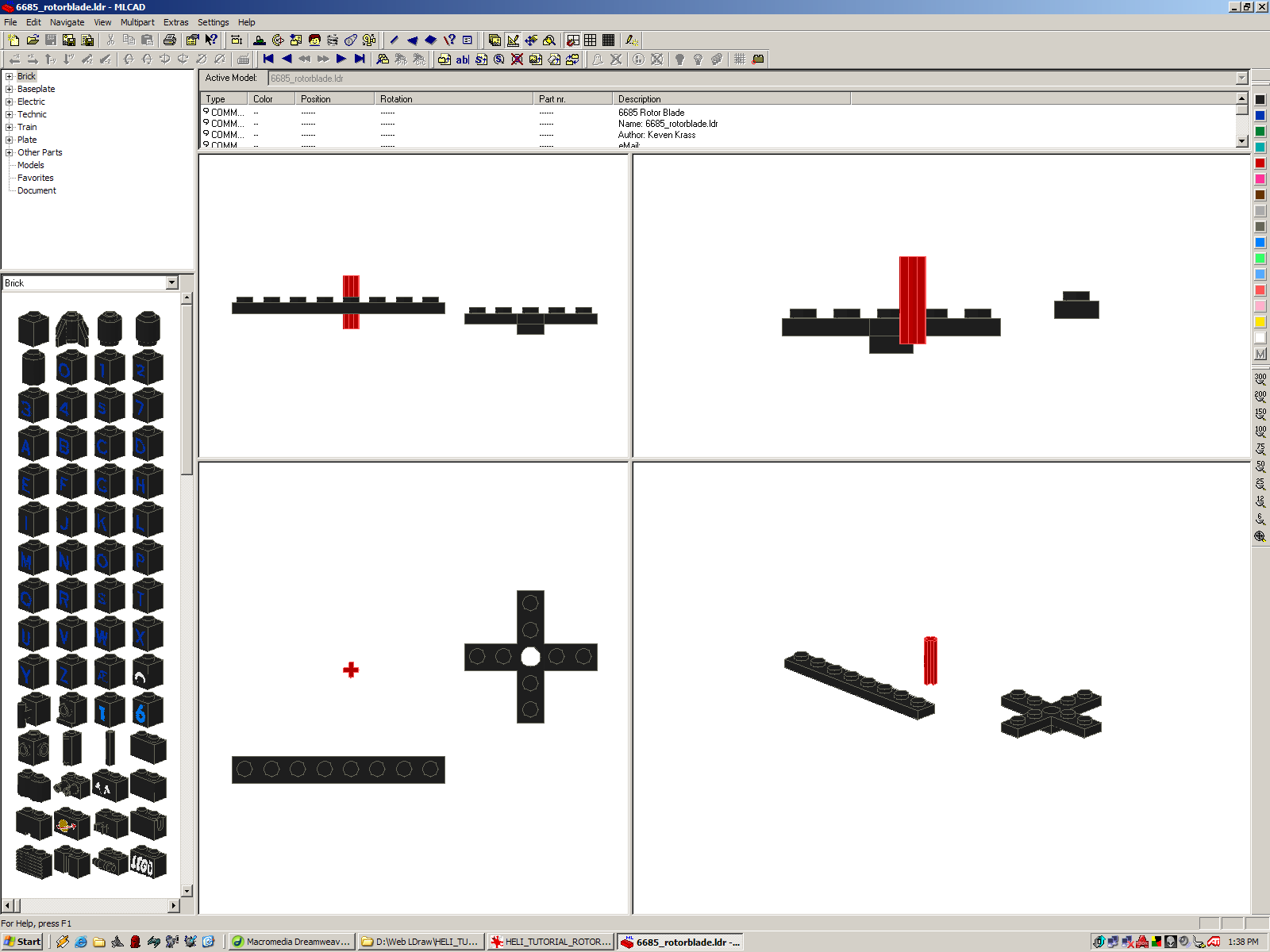

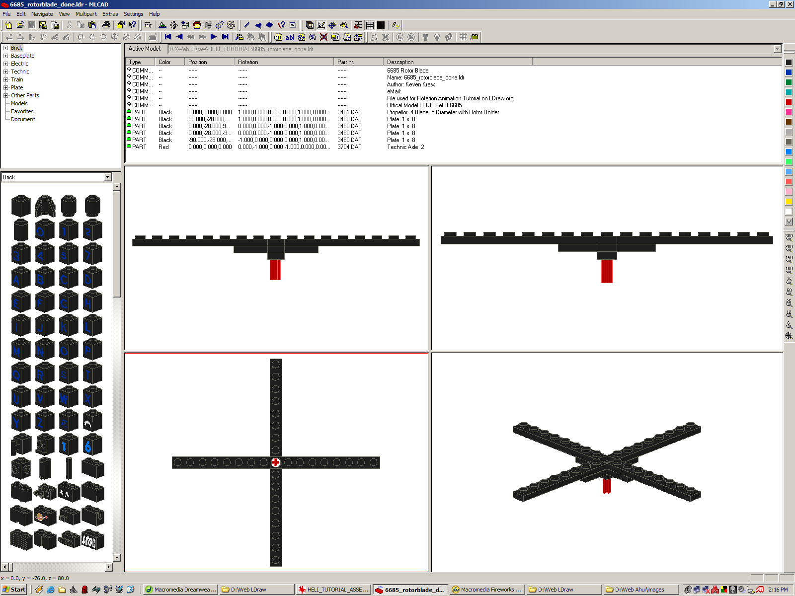

Open 6685_rotorblade.ldr using MLCad. You should see something similar to figure 2.
Figure 2: Viewing 6685_rotorblade.ldr in MLCad
The file is made up of three parts: Propeller 4 blade (Part # 3461), 1x8 Plate (Part # 3460), and Technic Axle 2 (Part #3704). We want the rotor blade to rotate around the center hole of #3461 propeller 4 blade, so we need to place that hole at coordinates 0,0,0.

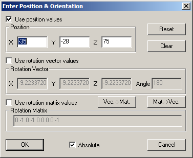

Click on #3704 technic axle 2 place it at 0,0,0. One way of doing this is to right-click on your mouse (while the part is active) and choose the "Enter Pos. + Rot..." command, which will display a pop-up window shown in figure 3.
Figure 3: Changing coordinates of a part in MLCad
Replace the values in the X, Y, Z boxes with 0s.

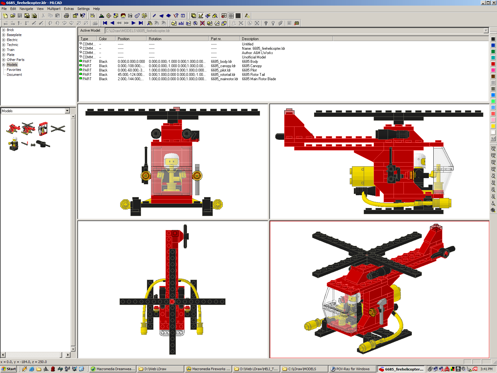

Open MLCad and click on the models category on the left hand side to see all the sub models of the helicopter and begin to drop and drag the sub-models to build the final model as shown in figure 5.
Figure 5: 6685 Fire Helicopter
Note: You must close and reopen MLCad to allow it the ability to refresh the models folder. Otherwise our newly created file (6685_mainrotor.ldr) would not have appeared.
Hint: When you place the 6685_mainrotor.ldr submodel on the body of the helicopter use toolbar menu items to see how it will rotate in the animation. Similarly use to see the rotation of the tail rotor. If they rotate "funny" then the point of rotation in each sub model file is wrong. Now would be the time to fix it!
Step 8 Save the file as 6685_firehelicopter.ldr and close MLCad.

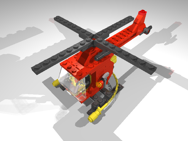

Step 9 Use L3P/L3PAO to convert the 6685_firehelicopter.ldr to a POV-Ray file. The default L3PAO setting will work fine for our example.
Step 10
Open the newly created POV-Ray file (we called it 6685_firehelicopter.pov) and render by clicking on the run menu icon. You should get an image similar to figure 7.
Figure 7: 6685 Fire Helicopter rendered in POV-Ray (default L3P/L3PAO settings)

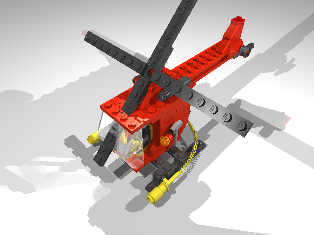

and re-render the file. You should get an image like figure 8.
Figure 8: Rendering using Rotate <45,0,0> in object main rotor.
The results are not exactly what we want for the animation but its all about trail and error. Try using rotate <0,45,0> and rotate <0,045> to see what type of results you get. One of them will rotate the main rotor alone the axis we want for the animation.
Hint: rotate <0,45,0> is the correct line of code for our animation. The keyword rotate and all other keywords in POV-Ray use the coordinates of <x,y,z>. Remember when you build the helicopter from all the sub-models and we told you to use the to rotate it? You were rotating the main rotors around the y-axis thus <0,45,0>.

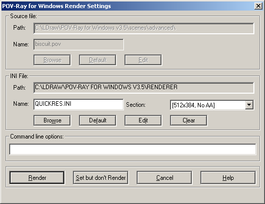

Save your modified POV-Ray file as FH_Ani.pov and open up ani.ini. It will look this this:
; Animation INI File
Initial_Frame=1
Final_Frame= 30
;Subset_Start_Frame = 1
;Subset_End_Frame = 30
Initial_Clock=0
Final_Clock=360
Width=640
Height=480
Cyclic_Animation=on
Pause_when_Done=off
Output_File_Type=N
; T - Uncompressed Tar 24-bit File
; N - New PNG (portable network graphics) format
; S - System-specific such as Mac Pict or Windows BMP
; C - Compressed Targa-24 format (RLE, run length encoded)
; P - Unix PPM format
Antialias=On
Antialias_Threshold=0.3
Of interest to us are the number of frames (16 in this case) and the clock values (0 to 360). You can use any number of frames but anything under 15 and the human eye will notice that the animation is choppy and a series of images instead of smooth motion. Our choice of 30 is to follow the NTSC Video standards (i.e. US television, VCRs). Since we want to blades to rotate completely in a full circle they need to travel 360 degrees, thus the final clock value of 360 is used. Cyclic animation changes the clock value so when we repeat the animation there is no jump.
Click on the POV-Ray ini Menu icon to open the popup window in figure 9.
Figure 9: POV-Ray INI Window Settings
Use the browse button to locate the ani.ini file and click "Set but don't Render" button to close the window. Instead of using the default ini file (QUICKERS.INI) we will be using our own custom ini file for the animation as the default file does not have the clock value we need for the animation.
