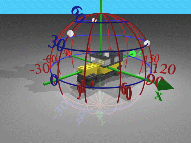

If you take a look at the picture below, you will see all three axes, as well as a "globe" that is formed around them. This globe is the key to understanding how to move the camera and lights. L3P considers the model to be placed inside this globe, with the center point of the model's bounding box at the same place as the center point of the globe. (For reference, the Bounding Box is an imaginary box that the model fits in exactly. The top of the box lays on top of the highest point of the model, the bottom at the lowest point, and so on.)
Based on this globe system, the camera and lights can be easily placed by specifying Latitude, Longitude, and Radius (also known as polar coordinates).
Latitude is in the range from -90 degrees (south, along the positive y-axis) to 90 degrees (north, along the negative y-axis). Zero degrees is at the equator. Longitude is in the range from -180 to 180, where 0 degrees is along the negative z-axis. 90 degrees (east) is then along the positive x-axis and -90 degrees (west) is along the negative x-axis.
The basic LDraw views can be represented by these Latitude, Longitude pairs: Front=0,0 Right=0,-90 Left=0,90 Back=0,180 Over=90,0 Under=-90,0.

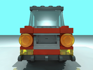

Open L3PAO, select CAR.DAT again and change the output name from to CAR02.POV Now go to the left column in the "switchboard" and check the -cg box. In the three input boxes, type in 0, 0, and -10 from left to right. Don't forget to add a floor and a background!
Hit "Run L3P", and then render the new CAR02.POV file
It will look like this:
Do you see what you did? You positioned the camera at the front of the model, and moved the camera back 10%. Fun, eh?
