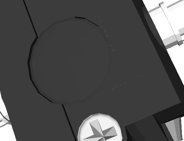

The following illustrates this problem:
Notice the white dots. If you view the file in wireframe, you'll see that these dots occur along the seams between polygons. Please note that the actual coordinates of all the points in the file are fine (as far as I know; I haven't checked, but I believe Mike). The dots are there because from that point of view, the edges are diagonal, and diagonal edges require rounding. Essentially, the rounding cannot be guaranteed to be the same on the polygons along the edge if those polygons don't share common end-points on both ends.
