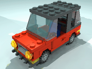

30,45,0 and Camera Angle 10 for CARCA010.POV

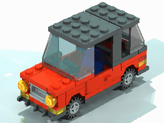

30,45,0 and Camera Angle 45 for CARCA045.POV

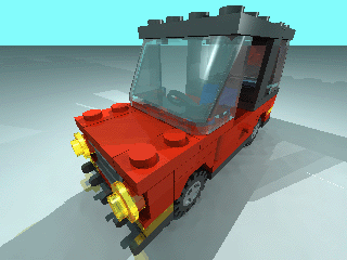

30,45,0 and Camera Angle 100 for CARCA100.POV

This is the image rendered at a 10 degrees camera angle. You notice that the perspective lines are almost parallel. This is great when you want to render building steps of a model. The camera radius is roughly 1453 LDraw units (a 1 x 1 Brick is 24 LDraw units high).
This is the image rendered at 45 degrees camera angle. It has a much more life-like perspective. The camera radius is now just 334 LDraw units.
And last: the image rendered at a 100 degrees camera angle. You will notice that the picture is quite different: you can see the horizon now because the camera is closer and lower to the floor, which causes the car to look a bit odd. You can see how distorted the perspective is: the two red studs on right side of the bonnet are almost twice as large as the two studs on the left side. The camera is now only 194 LDraw units away.
If you look at the shadows on the floor, you will notice that these are different too. This is because, by default, L3P places 3 lights on fixed globe locations and at the same radius as the camera. Therefore, in the CARca045 image the lights are very far away and lit a large part of the floor while in the CARca100 image the camera, thus the lights are very close to the model, and a much smaller part of the floor is lit. Hence, the floor looks darker on the horizon.
